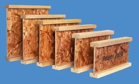

From a firefighting standpoint, I'd rather be working in a 150 year old ballon framed house built with rough sawn local lumber than a modern house built with these.

There is a reason why many cities and towns have a Truss Beam/Chord Ordinance in place . . .
Here in Bangor new construction (industrial -- not residential -- we pretty much assume almost all residential uses truss beams/chords) are required to put a placard on the outside of their building to indicate that trusses were used . . . reason being that once a few fail the entire roof or floor can suddenly and unexpectedly collapse. Lots of videos on line showing just how fast compared to traditional stick built methods . . .
Agreed but not all new homes are built with them by any means. And balloon framed home are scary to see when they burn it is amazing how fast they burn. But i totally agree those beams and trusses are absolutely a problem in a fire

per Hubby the fire fighter - "Synthetics are like adding diesel fuel to the fire". He just completed a fire investigation ... siding was darkened but intact as it was cement board style but the fire progression was interesting. Board insulation under the siding poofed but the wood furring strips for the siding slowed/kept it contained so it travelled upward more than outward.
He's not a fan of engineered trusses - recent fire at home that one would anticipate legacy construction was not so. Really glad no one tried entry (too involved on arrival) as old/new portions of structure created huge hazard potential. House was added on to (part basement/part crawl space) and used engineered floor joists without rim joist.

We refer to the "modern" furnishings a solid gasoline. Measured in BTU's they contain much more than the legacy stuff made from natural products.
