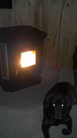

Talked to the Ol Man about joinin here since I installed his Englander 25-PDV this Fall. Was burnin good. He had it 78 in there, with settings on 3 heat and 5 fan. Took a quick pic too.... They have a Chocolate Lab named Cocoa, as seen in photo.

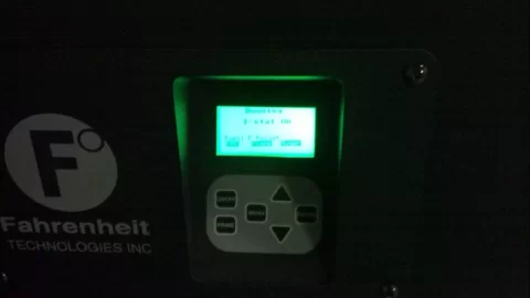

Didnt mess with the T-stat tonight. Started it up and just gonna let it idle through the night. Did it a couple nights now. Been keeping it on Heat level 2. Have the Quad set on the T-stat if needed. Supposed to get Cold tonight. High of 29* and low of 12*.
Alright..... Done.. Its official. Stat is working.

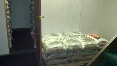

Stopped after work and grabbed some "Old Dominion" pellets (15 bags in the Focus). Also picked up 2 bags of one of the worst pellets around here (Natures Junk) just to try this year, because it was a new batch.

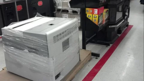

When I was gettin the Old Dominions from TSC, I looked at there stove selection. Had several stoves. One of them was the Bay Window US Stove (pretty) and the other was the Window unit. Damn is that thing HUGE. It would take a large window to fit it in..... Didnt measure, but WOW. Also, I know believe in the plastic hopper (WTH). Plastic??? Didnt have the ABC control panel, so it had to be newer.

Has anyone burned the Old Dominions yet this year? I searched them here and they didnt seem bad. $4.00 a bag and they "say" they have Higher BTU's and less fines and ash than anything else I have. Also say they are an "Ultra Premium" Pellet...

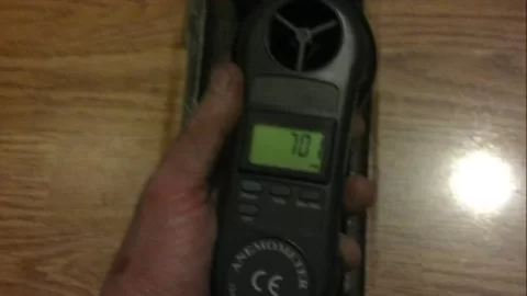

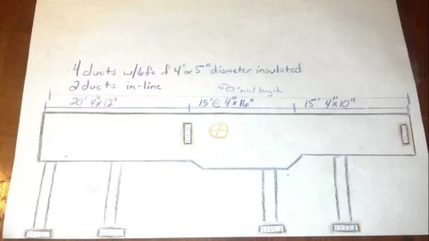

Mepellet.. Here is some info. The main line is 50 ft. It actually goes down in size on both ends. One end smaller than the other (just went into Bar/Pool room last night and seen it) Its 20 ft, 15 ft, and 15 ft. Used my kids colored pencils. The Orange circle with an X represents where the Fahrenheit is. Sorry for the sloppy handwriting.
There are 6 registers. 2 are in-line and are set right into HVAC through the floor. The other 4 range from 5 ft - 6 ft away from Main line, what I think is 5" in diameter on the inside (8"-7" O.D. but insulated also)

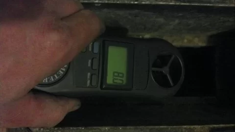

The 2 inline registers are running 700 FPM air flow with the meter or 8 mph. The 4 ducts are about half that. With the 2 closest to the furnace duct being slightly higher than half.
I didnt restrict the air flow so it all could flow through the meter. Just set it at floor level. I gave the meter back to my buddy. So if the #'s are not what you were looking for, then I can borrow it again.

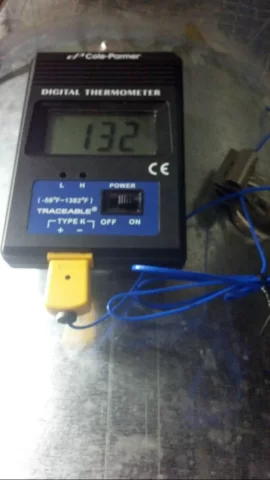

Its an 800 CFM blower and I am getting 130*-140* with Easy Heat pellets (my shoulder pellet) Still saving the good stuff. So I am very optimistic that this should do well in the Cold months. I am thinking about "flipping" the 10" duct off the furnace. It would give it more vertical before the 90's. Although in terms of resistance it may be the same (I dont know??).. Anyways.

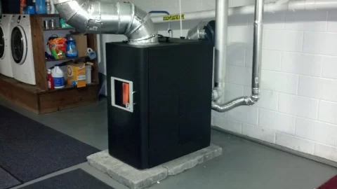

Almost 2 seasons in and all I can say, is I love this thing. I never gave my 1 month review, but I never really cleaned it till the end of last season. So far this season, I have emptied the ash pan 3 times. And it is FULL when I empty it.

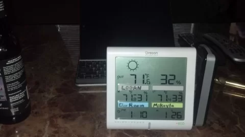

I still only run it on level 3 on t-stat mode. Most nights, it idles on level 1, keeping the bedrooms about 71* (average). But I also have a rather large wood eater right next to it. So I am adding a few extra BTU with that ;)
I ended up replacing a few parts. The hopper gasket (internal), the door gasket, I added a 2nd layer on the ash pan gasket, the new high flow sail switch, new updated high flow exhaust manifold, and I also closed up about 20-25 holes, in the upper sides, front, and back of pot (total on all 4 sides). I must say that the burn is Awesome. Compared to the 1st day of install and no OAK, to today, with all updated parts, board, and mods, it runs like a champ!!
Love this furnace, but love the fact I am replacing the Quad (gonna try again) this year. If the new stove works as I think it should, I may not use it much next year. Just to play with the new baby!!
Anyways. I figured I would update this old thread, for future reference and those that may look at the Fahrenheit 50F. It's a pretty stout unit. Even though its only rated at 50,000 BTU, it can hold its own.

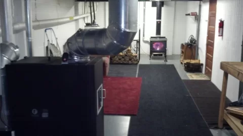

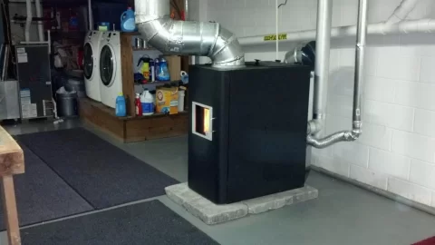

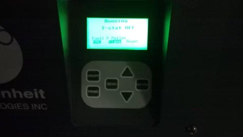

Here are some updated pics and short vid on the auto clean and regular burn
[Hearth.com] Fahrenheit Endurance Install [Hearth.com] Fahrenheit Endurance Install [Hearth.com] Fahrenheit Endurance Install [Hearth.com] Fahrenheit Endurance Install [Hearth.com] Fahrenheit Endurance Install
Here is the auto clean
Here is a regular burn. Level 2 and the wood eater with a good secondary burn. :)
