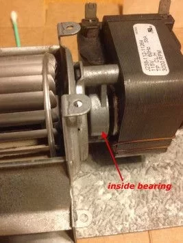

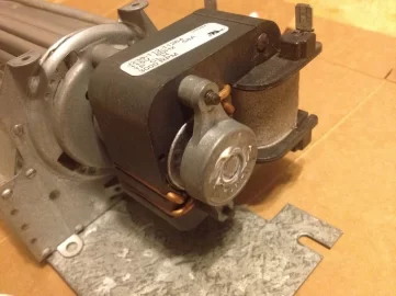

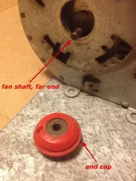

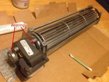

I finally got a T-20 driver long enough to reach the top blower screws....I took the blower out removed the red cap and cleaned and measured the fan (for possible generic replacement). I added grease inside the metal bushing (in the red cap, far end). Both bearings for the fan are located on either side of the motor, I could add grease to the outside of one and I used spray silicone for the blind sides on the outside bearing and both (blind sides) of the inside bearing. The opening for the fan to the stove is ~ 12" X 1.5". I re-installed the blower and it has been running for 14 hours with no squeaks / grinding yet...but I think I'm going to be searching for a replacement.
