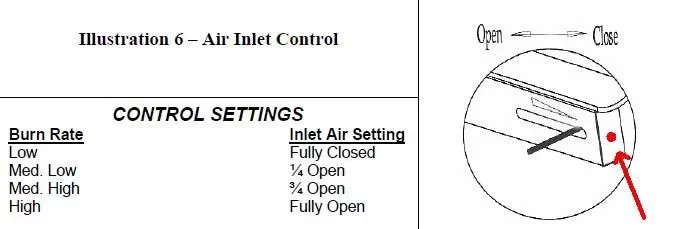

The air control "box" over the door has a screw at each end that you loosen. When you tighten them, press the box against the stove. This seals the sliding plate within that "block" against the stove tightly, really making sure less air is flowing in when it's shut down tightly.
Not that it will help a lot, but here's a picture I pulled from the manual. I had to add the screw that I'm talking about, but if you look at your stove you'll figure it out. You should be able to do this even with a hot stove, just wear gloves and be careful.
It's one of those things that is so simple it was easy to not consider it. I spent forever trying to figure out if my gasket was going or something.
