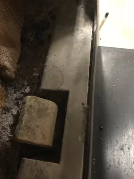

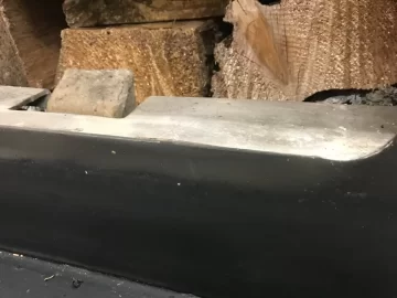

Englander NC30 warped plate
Here’s mine. Seems to be the way these things are built and not in need of fixing. Too much more weld along the stove shell could just cause the door opening to warp and create a leak.
