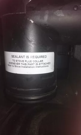

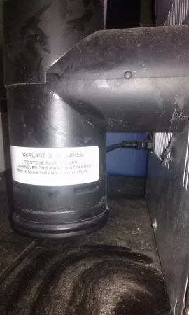

Marina, you probably need to clean the whole vent. To clean the venting you can run a brush through ( Lowes or HD will have that too most likely). Do you have a T inside with a cap on it ? if so you remove the cap and inner cap and run the brush up through. There will be ash and dust, I let it fall into an empty pellet bag and have the ash vac ready to turn on to get the airborne stuff. Done deal, close it back up.Okay, here is what we did this morning. I got rid of anything resembling a combustible material near the termination cap, went to lowes and bought stones and put them down. Then I adjusted the air flow gate which is now half closed...it was almost totally open. It's running on setting three and no embers so far. I am going to try turning it up to the highest setting and see what happens. I know I can play with the voltage settings as well...

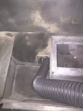

Marina here is a photo of vaccuming the exhaust chamber if you have never done that it probably wouldn't be a bad idea to do so.that leads right to the exhaust fan.I do mine once a week.

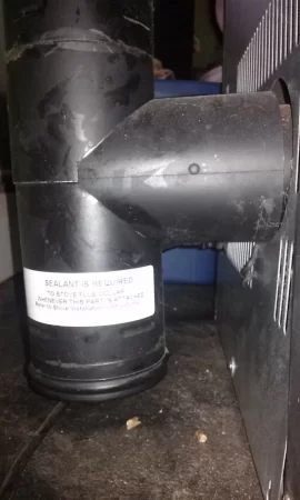

Do you not have a T before the vertical rise of your vent pipe at the back of the stove ? If so, open it up and run a vent brush up there, have your ash vac handy to suck the dust from the air. It does a great job. If you don't have a T you might want to think about that and add one in. 3" vent with relatively ashy pellets needs to be done about every ton, a bit less with really clean pellets. 4" vent can go longer, I do mine at about 2 tons ( 23ft vertical rise with 4" liner ).I just have to figure out how to clean the stove pipe...

I think I do...I am going to look at it tomorrow...unfortunately...having to be at work so early gets in the way of everything. It looks like it's sealed from what I can see which is why I didn't want to pull anything off the stove yet until I can get down on the floor and really get up close and personal..![]()
