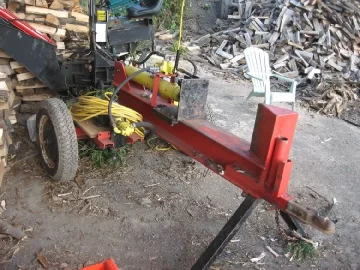

Well...I picked up the Flowtron. LOL !
The motor works. It's about as loud as a circular saw.
The ram is hung up at the far end somehow.
For $25, I figured I'd take it home and mess with it.
If it is too slow for me I'll look for a local senior citizen that might want it.
I figured it out. There's a brass block with a threaded hole through it that carries the ram back and forth on the drive screw.
The threads are buggered. Now to find out if it's worth the $ to have a new block made. It's @ 2"x1.5"x2". Maybe I could have
a length of square stock drilled and tapped and cut several blocks out of it so I'd have spares ?
