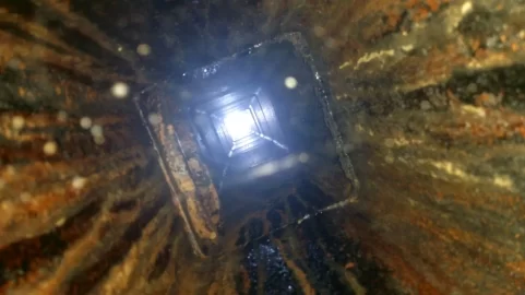

4. I have a hard time seeing what my chimney looks like from the bottom, even with a light and a mirror in the clean out.
One thing that I've found to work really well, is to just use a cameraphone with the flash on to get a good look up your chimney. I just hold mine in the cleanout door and snap a few pics. [Hearth.com] education in chimney fires

The presence of creosote in the firebox doesn't really tell you much about the situation in the chimney. As brant suggests, stick a GoPro or smart phone or small digital camera in there for a look-see. Or, just run a brush up it and find out. The nice thing about a video is that you might be able to see any cracks or other flaws in your chimney liner (assuming it's lined and lined with ceramic tile). If it's not lined, don't even think about burning any more wood until you get a liner in there. If it's got some serious cracks or other problems, best to shove a stainless liner in there as well.
