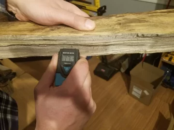

I see you saying you are testing the sides versus the ends which is good.
But in order to get an accurate reading you need two things. A piece that is approximately warmed up to room temperature (70 degrees) and a freshly split split piece.
That means you have to let it warm up, then split one of your test pieces, and then immediately stick those moisture meter probes into the newly exposed side.
Is that what you are doing? If not, you are doing it incorrectly.

Thanks for the tip. I can see the logic, that a split begins to dry on the surface as soon as it is split, resulting in a lower moisture reading at the exterior than the interior. However, I do push the two probes hard into the wood. That alone will produce a reading approximately two percentage points than if I simply bring the probes into contact with the surface. In another comment, somebody noted that moisture readings are not accurate but do provide a relative measure. Splitting stove length pieces indoors is a recipe for disaster, at least in my house. I do occasionally split kindling on the hearth, but nothing larger than kindling. I had a lot of Boy Scout experience with hand splitting 55 years ago; saw one of the dads sink an ax between his toes. I'm handy with hatchets and axes, but safety comes first. Thanks again.
Well nobody is saying that you have to split it inside your house. We are just saying to bring it inside to get it to room temperature and then split and test.
I know you think you are getting a good reading by jamming the pins in hard but it just isn't going to be an accurate measurement. The only way to get an accurate reading is...
1. Split a piece of wood that's approximately 70 degrees
2. Insert moisture meter pins into the freshly exposed face of the wood.
3. Read the meter.
That's the only way. Any other way and your reading will be incorrect. You could be as far as 15 to 20 percentage points off by not testing on a freshly split piece.
Try that and post up the results.
3. Read the meter.
OK, you made me curious. I risked life and limb to split a room temperature 2x2x2 triangular split on the hearth. Got 15% on the old split surface and 16% on the newly split surface. I pressed the probes into the wood in each case. Well, it's not 15 to 20 points, but it does illustrate that the interior is more damp. The split was seasoned from the middle of last summer. On the other hand, what do you suppose is the accuracy of the typical $30 General Tools moisture meter from Home Depot? That's what I have. I thought the $150 and up models were over the top, since I can tell if a split is good to burn by appearance, feel, heft and sound of knocking two together. BTW, I restoked the stove 20 minutes ago. I filled the box north-south with a 4x4 of ash that was cut and split yesterday, seasoned ash splits and pieces of ash slab. With both dampers open, the firebox is full of bright flame, stove top temperature rose from about 250 to about 480 and the sides of the green piece are glowing red just like the seasoned pieces. Last winter I also experimented with firing unseasoned with seasoned wood and had good results. The stove pipe and flue were clean as a whistle when inspected last summer by the stove dealer. The flue is Isokern precast and about 35 feet tall. I also have an Isokern fireplace flue and firebox and have never had creosote deposits there either in 25 years. Isokern is precast from volcanic rock mined in Iceland. Amazing stuff. Four years ago a neighbor using a steel fireplace and stainless flue pipe in a wooden chase burned green wood repeatedly. The flue went off like a Roman candle and the chase caught fire and fell off the side of the house. Smoke damage throughout. The restoration took six months.
Well here is a quick example.
Here is the outside of a piece of maple. It's been seasoned 18 months
The outside reads 9%
[Hearth.com] Dry Ash
Here is the reading when I split it and stick it into the freshly split face. 17%
8% difference. If that was oak I'd bet the outside would be 9% while the inside was around 35%. That's a huge difference and 35% isn't really burnable in an epa stove.
