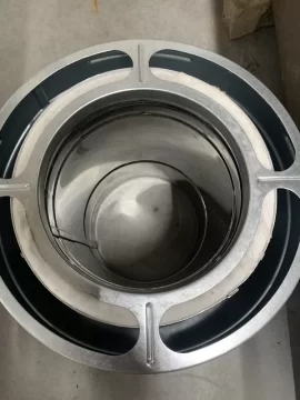

Hmmmmm, none of the triple wall I've seen has any kind of insulation blanket in it. Hopefully, the OP has the Duarplus triple wall that you are talking about.
