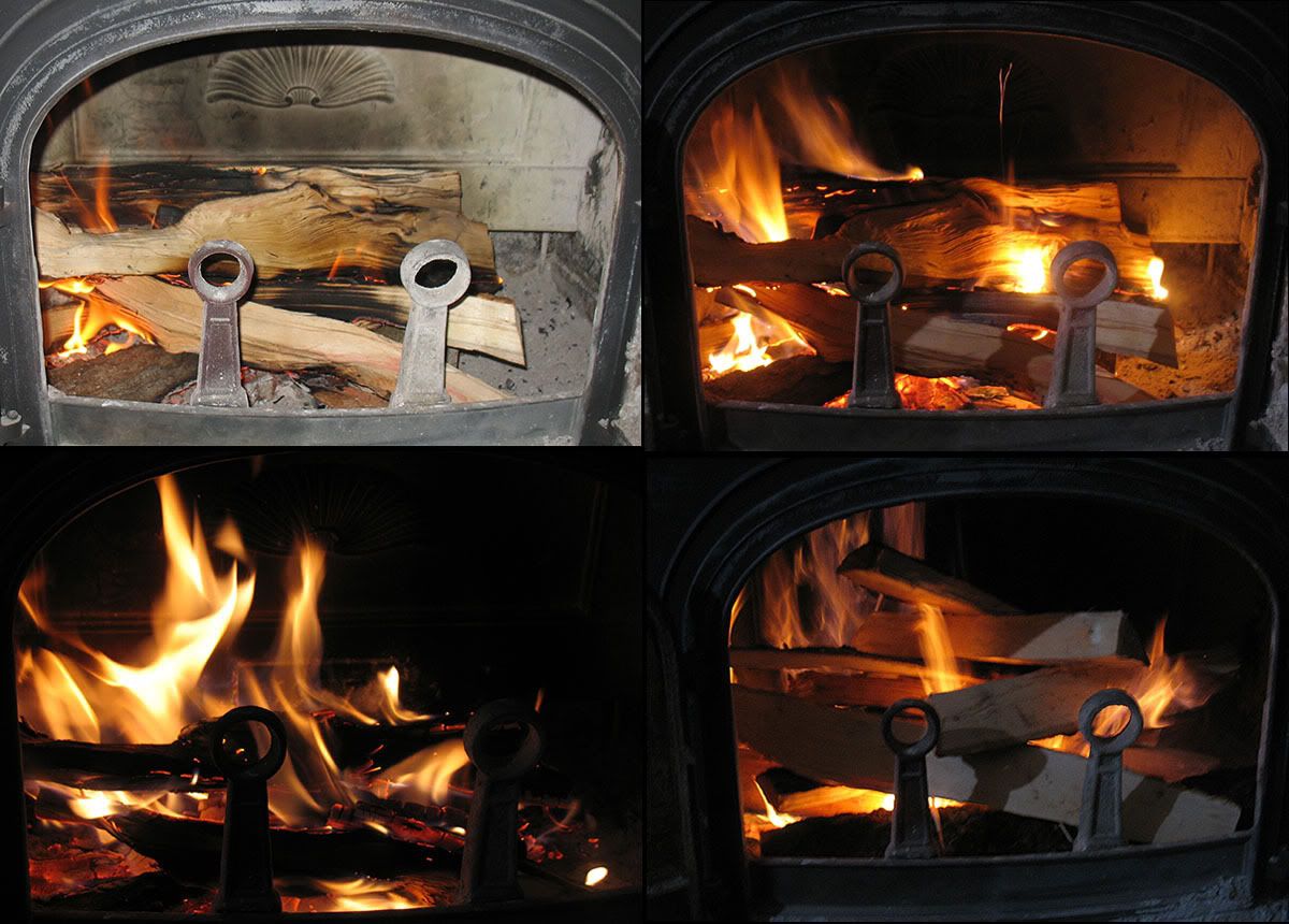

Here's a sequence of the second and third additions. It was a few minutes after the last shot was taken that I went outside and recorded the second video segment.
[Hearth.com] Does unseasoned wood still burn ok?
Compare the back of the firebox in the top left shot with the initial startup photo. When I went down in the morning that day there was some soot buildup in the back corners from the night before. That burn was hickory and cherry that had been in my stove room all season long (bottom of the stacks), then was moved outside in April to season for another 9 months prior to bringing it back inside. The wet wood in the beginning didn't foul up the stove at all, it actually cleaned away the soot.
BTW this all occurred within a short time frame that you wouldn't even get a secondary burn in a modern stove, so that point is moot. Besides, what would fuel it? There's not a whiff of smoke in the box in any of these photos. With real dry wood there would be visible smoke. As well, you can already see blue flame starting to appear in the back of the box in the last photo - a sure sign of clean burning.

Not real easy, but not all that difficult, either. Those small splits were just the beginning. And it took four careful additions to get the stove cranking nicely. It the end, I just dropped a bunch of normal size splits through the top door, ran the flue up to 650ºF, shut the bypass and the secondary just lit off like an oil burner. WHOOOOSHHH! Flue temps dropped and stabilized over the next several minutes, and stovetop temp went back up to about 700º and stayed that way for about an hour before beginning a slow, steady decline over the next several hours.
Now, Pen, if you were to sneak into my basement and switch out my stove with your 30, I wouldn't complain to anyone. But my stove isn't just some one-trick pony airtight, it actually gives a decent secondary burn. Getting that to light off in my stove is harder than burning wet wood in it, but once mastered it works quite well. As I mentioned elsewhere, my stove was tested at 63% overall efficiency in the updraft position, but it's way more efficient once that secondary lights off and you shut the primary air down. It was one of the best of its era. VC tried to improve it by adding a cat, but cat technology was in its infancy back then. I'd love to be able to add a cat to this baby, but the design of the stove won't allow you to just do that. It's a real heat meister for its size, that's for sure.

Yeah, maybe someone can point out the "wet, heavy, high-density smoke" in my stove or coming out the stack, because I can't see any. %-P
You have to remember that there is about .54 pounds of extra water generated for every pound of wood fiber burned... right there inside the stove. It evolves quickly, too. As a matter of fact, the faster you burn, the faster you make it, and it will continue to be generated until every last molecule of hydrogen has been consumed and only charcoal remains. It's a product of hydrocarbon combustion, after all. Is is a different kind of water than the residual water in the wood? I don't believe so.
As far as smoke density, it is a well known fact that dry wood makes denser smoke than wet wood. Wet wood undergoes pyrolysis very slowly, so smoke evolution is retarded by comparison. Put a big load of kiln-dried mill ends on a hot bed of coals and see what I mean.
