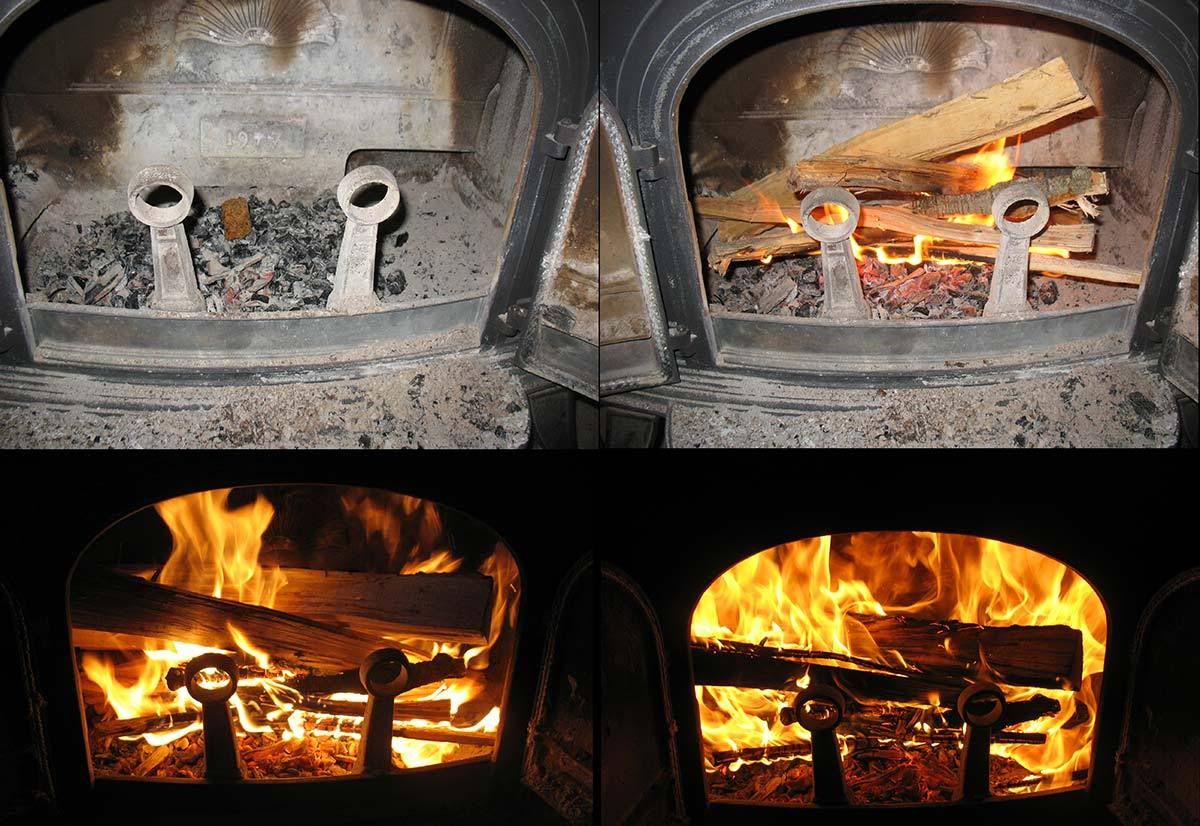

68% MC. Holy Cow... that's WET!
Well, I got close with the burn I documented. Average MC was 57.5% MCdb when I tested samples the night before. Note, though, that the entire fire was started with the same wood. No big, raging fire and huge coal bed, just thin pieces of wet wood fed onto a small coal bed from the night before, with a small chunk (maybe 1/8 the size of a SC) of my own personal rocket fuel fire starter to get the initial blaze started. No door cracked at all, just the intake air in the back of the stove opened all the way between additions. I got the fire going so quickly that way that I didn't even have time to write down the times, I had to go back and look at the time stamps on the digital photos to get a timeline on the whole process.
Here's an shot of the starting sequence:
[Hearth.com] Does unseasoned wood still burn ok?
Looks pretty self-sustaining to me.
At no time during the burn did it falter, nor was there ever any really noticeable smoke coming from the chimney. On a breezier day it would have been carried off quicker than you could see it, and when I did see it the duration was brief. Maybe a minute or two. Stove temps rose rapidly from a basically cold start. 45 minutes later, the stove was at 750ºF. I've read posts here where the guy had trouble reaching 400º after several hours with seasoned wood. The answer has always been that the wood is not really seasoned, the only evidence being the reported quality of the burn.

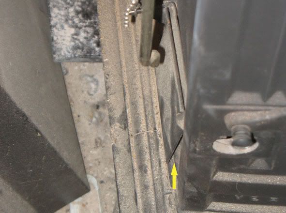

I disagree with the 50% possibility. Not with freely burning wood, anyway. If you add too much air, the stove temp will drop too low for proper ignition temperatures. Flue temps will drop as well, so more air coming through won't cause more sensible heat loss, just reduce the quality and rate of the burn. Wet or dry, it's all about finding the sweet spot. For that particular burn, this was what it settled in at after I shut the bypass damper and the secondary burn lit off.
Secondary air intake opened all the way, primary intake closed down to about 1/8 the cold start setting. Cruised like that for hours, too, clean as a whistle and plenty, plenty heat in the room.
I've yet to read that trouble out of someone burning in a pre-epa stove. It's always an epa-unit. Usually they claim the fire looks good until they close the door. Unless the door is cracked, a modern secondary air stove just doesn't let a rush of air in, they need draft to pull it in and it ain't happening unless that flue is hot. Kinda get's the operater in a catch 22.
Also, burning wet wood is a lot easier when it is split as small as you have pictured. Many are throwing in rounds and average sized splits that are wet.
