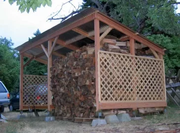

A very useful project this spring would be a proper woodshed. We move our stacks into the woodshed for final drying. That ensures good cover and ventilation and nice dry wood all winter long.This shed holds 6 cords of wood.
