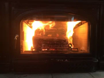

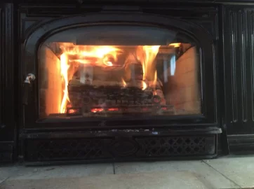

I packed my insert with black locust just now, I left 3-4 inches on each side and the glass is crystal clear......so it's got to be about having the airspace in your stove....... I did get more wood in by doing it this way as opposed to the other ways....
Like this..... [Hearth.com] Dirty PH glass with 3YR Wood[Hearth.com] Dirty PH glass with 3YR Wood
