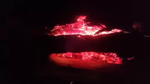

Ok.. so heres a reload that I just did.. the stove was already running.. cat was already engaged
this was what the stove was..
Stovepipe.. still good draft.. about 2w5 on the outside of the double wall
STT 490.. its a little higher because the box is mostly coals and just burned down
cat temperature 855
picture of what the box looked like and the air cut back all the way

From the post above.. with the stove in those EXCAT CONDITIONS..
All I did was open the bypass.. load wood.. immediately closed the bypass.. I never touched the air.. it was left colsed the entire time..
Now my STT is 380
cat temperature 1206 and hanging there
this what I was doing to the box.. just added some wood.. not a ton.. in total was 3 splits
So why did my STT drop moe the 100 degrees.. because the STT is not exposed to the coal bed.. theres a bunch of wood now sitting on it
in the past Iv shown my STT with the air all the way back and for some of you the read it thought it was a little high.. its high because.. theres no wood in it.. its all coals.. ready for the next reload..
