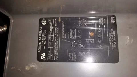

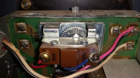

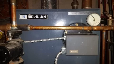

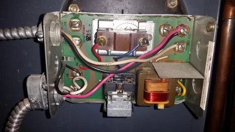

What model aquastat do you have? Pics of it?
Most use a differential setting/dial to set the operating temp spread.
I think a good portion of your excessive DHW oil use is due to that high 180 cut-out. It should be possible to adjust that back, to something like 160.

Looks like the range of adjustment on your stat is 180-240. From some searching, I think that stat came in either that, or 120-240. So you're likely stuck unless you replace that stat with one with a lower setting. But if you don't make any other changes for a while, it might be worth the cost to replace. $138 on SupplyHouse site.
IMO, I don't know why they would put a stat that had a low range of 180 for its high limit. That leaves you with practically no adjustment range. And wastes a LOT of oil heating dhw in the off- heating season.
But there isn't another stat on the boiler anywhere is there? But on further thought on that, if there was that would be your low limit, which would set the min temp the boiler would maintain itself at, and have no effect on the high limit.
Reactions: davidmsem
