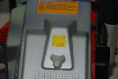

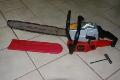

Here be the $20 saw... note the price tag. Has a near new 3/8 rim drive and Stihl semi-chisel chain, 20 inch Oregon Power Match bar with just a hint of burring on one side, and an adjustable oiler. It may be a 'near new' saw... the paint is hardly nicked anywhere, including the bottom. The clutch did not have that much caked up on it for an outboard. I will be putting fresh gas in it and giving it a test in a few minutes. I even had an odd-ball mini scrench in my saw tool box that fits it.

I poured out the old gas and oil, and put in fresh gas mix and tad more oil to make it 40:1 (to factory spec) and fresh ~canola~ oil. Then I pulled the plug and looked inside. No scoring on the transfer or exhaust side. Poured in 1/4 tsp of premix oil and pulled her over a few times and let it sit for a while to let it get into the low end. Then I put in a new plug (exact same as Stihl NGK plugs, I have many of them) as the old one was carbon coated black. Then I looked at the chain, and it as dullsville. So on sharpening it at 30 degrees, I noted that it was a factory 35 degree edge. So I was the first to be re-sharpening it. Can this saw be that new? At least the bar, chain and rim are that new.
So on to the starting test. Pull the choke out, flip the kill switch up and pull 4 times to get a rumble. Then push the choke in and pull 2 more times, and whallah! It comes to life! On WOT it burples nicely, so it is tuned. It also idles perfectly. On to do some cuts. Slices through apple like buddah! Shut it down, and re-started it on one pull. This baby is all set up, with minimal effort.
OK, there is some bad news... now my CAD is back! All for $20 and a new spark plug. The 4WD trail saw is ready for off-roading. Not sure I wanna make this my loaner saw. It runs too good for that. Maybe it will become part of my permanent chainsaw (Homer Simpson wiggly fingers) ~collection~.
