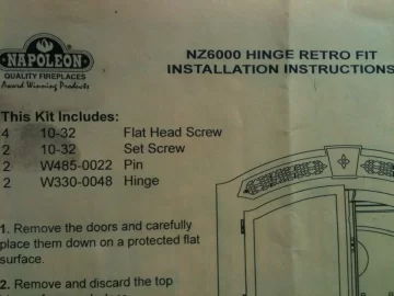

yes the hinges started to bend by oct.2010,... a newly designed hinge set was received in jan. 2011 and the doors have not sagged since.
