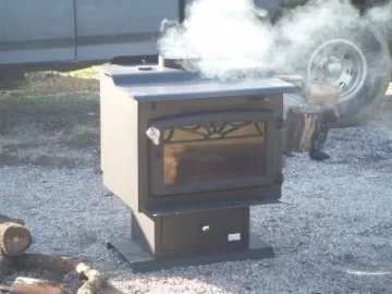

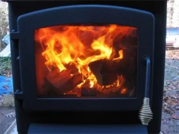

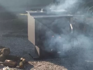

My son and I carried the stove (Century Hearth FW300010) outside and built a fire in it. With the door open I could keep the fire going but every time I closed the door it would just smolder. Damper is fully open. Temp only at 200 degrees. Out side air temp is currently 50 degrees, plus the glass is nearly blackened out. I thought the wood may be damp because I could here it fizzing when I had the door open. My son went and picked up seasoned, dry oak. We started over again. Same thing is happening all over again. Could all this be because there's no stove pipe connected on top or is this normal? I thought I would be able to watch the logs burn not smolder. Be fore I sent this I checked it again. Stove temp 200 degrees, glass nearly darkened out. I opened the door and on fire, just smoldering again. Damper is fully open. Please send advice, Thanks

The fizzing indicates wet wood (also a problem), but as previous posters indicated, no chimney=no draft. Those restricted air inlets need a decent draft to pull the air through once the door closes.
Put a couple of pipe sections in the top and let'er rip. This one is at 550*.

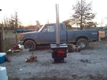

Pic below. Thanks for everyones advice. I sent me son to the store for pipe. Added 3ea 2ft sections. It did the trick. Very little smoke coming out the pipe. Temp at 500 degrees. Glass will have to be cleaned with oven cleaner tomarrow after I'm done heating up my truck tonight. I lowered the damper all the way down and the second burn kicked in at the top tubes while the fire on the logs disapered. Thats cool. Opened it back up to finish the burn tonight. Brotherbart, I remember your pictures from a month ago and did'nt think about the pipe. Again thanks everyone.
Oh ya, look behind my truck to the left, youa'l see my wood stacks. It all came from a tree in my yard. A friends 18" chain saw missed reaching the middle by 2"s. Those blue tarps are worthless. Spring I'm going to build a single wall north to south 10' x 75' with a roof expanding out from the wall around 10' or 12'. Opening will face east to store all my wood.
