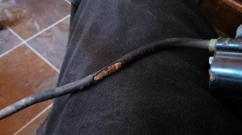

So, new coil ordered after I pulled the plug and checked that side for spark and got....nothing.
I'm thinking this is why. I hate those meeces to pieces.
