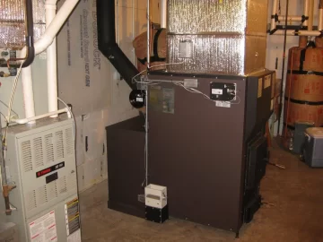

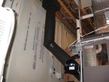

Is this a certified stove & fireplace business?? They should have no issues doing what you need to have done. I just installed a Kuuma this summer and my insurance required the same thing. I had a local certified stove & fireplace company run a brand new 32'+ Excel chimney on the inside of the house. They also hooked up the Kuuma to the chimney with Excel stove pipe. Sounds like who you called are not even certified to do what your asking them to do.
[Hearth.com] Chimney pipe connector questions [Hearth.com] Chimney pipe connector questions [Hearth.com] Chimney pipe connector questions
Reactions: hobbyheater
Is that OSB on the floor?
Oh good. the floor was fuzzy on my screen in the pic. Concrete is good.
BTW, OP, the place that connected mine told me it's CODE to have the male end (crimped end) slid into the female end and have it positioned so the female end is pointing up (crimped end pointing down). This is to allow any condensation or creosote which may form to run back into the furnace and not on the outside of the stove pipe, which will happen if you position it the other way, which will be a fire hazard. My Kuuma owners manual states this same thing.
