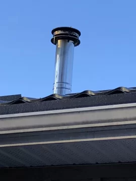

Had a chance to go have a look. I am not seeing any new stuff dripping now that the new cat is in place. In fact the chimney cap has actually become much cleaner than it was before, although I'm not sure how to explain it.

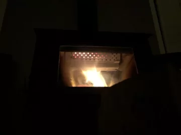

First, the glass is getting dirty again. We had actually noticed this burning season that the glass was always staying pretty clean. I assume this is because the wood only needs to smoulder now to keep the right temps.
Second, in the morning there is a lot of wood left in the stove. Before I had only embers, even on a full load.
No smoke coming out of the stack.
Your cap may have just "dried out" now that less creo is making it up there, and flue temp is probably a bit higher.
I replaced the cat several days ago, and noticed much the same..more wood left due to lower air settings, more heat in the house from the load due to the cat burning what's available more completely.
I don't think I was getting smoke during the burn, but I kept the air open more in an effort to keep the cat burning longer. I didn't look at the stack much, later in the burn, but I think I would have smelled smoke, if there was a lot; The wind blows chimney exhaust to where I enter and exit the house, quite often.
