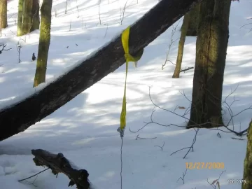

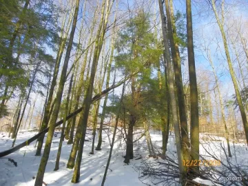

Picture 100 0375 is the hung up Cherry and 100 0376 is the winch hook up I started with. 100 0378 is after I winched it against two trees, I thought that if I got that far it would come down(I was wrong). Picture 100 0377 is well how do I say this, up the hill down the hill and then the battery died. Back in the woods 1.5 miles best guess and going on 2:00 pm what do you do, waited about 20 minutes and the rhino started. Most smart people would call it a day(not me) lets winch down that cherry, battery goes dead again. This time it seems I'm in for a long walk, tried about 4 times and the rhino is saying walk, call the wife on the cell and explain things so I decide to try one more time (the rhino started) packed the gear and left for home. Winching 101 classes coming up.
The cherry did come down alot, will go back at it Saturday.

Keep the engine running when you're using the winch.
Maybe change the pulley to the cherry.
Wrap it on the cherry, tie one end of the winch rope to a tree, thru the pulley, other end to the winch, you'll get double the pull & easier on the battery
Sometimes helps when you need to pull at weird angles too.
From the pics you already know that.
Will be better wood since it's taking more effort to get it :)

The direction I started winching the tree was wrong, if I positioned the rhino like I ended up the tree would be down. I need another tree saver,snatch block and d-shackle.(Off to Tractor Supply this week).
