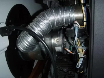

This is how my installer left this (picture attached). I'm gonna guess that the intake hose should actually be connected.
I've got other issues with this installer (leaky vent pipes, crappy looking finish work). I'm just wondering what other people think about this - should it be so hard to get this thing installed properly?

If the idea is to have cold air spilling into your house, this is a great setup!
What's up with that homemade flange?
Probably had it taped on but when the stove heated up the glue on the tape soften and slipped off. On mine the OAK just sit inside the flange, Call him back or tape metal tape or use a hose clamp!
I'm sure you paid a premium for that install! Was he wearing big fat clumsy oven gloves when he hooked it up?
Looks like your installer is quite an assclown.
I'd get him back there to do it right.
What an absolute shame to see but it doesn't surprise me. I would contact your state Better Business Bureau and email them the pictures and see if they can't help you get this resolved and installed properly.

No it's not duct tape, it's actually metal tape that's spray-painted black. I think the flash makes it look like duct tape.
I'm trying to decide what to do. These guys have been out 4 times; frankly i have no confidence in their work and don't really want them back in my house....
While I haven't been able to find a leak in the vent yet, there is smoke smell when the unit fires up. One theory would be that it's coming from the fresh air kit shown. For the previous vent leaks, i was able to see the smoke (as well as smell it) with a flashlight or laser light. This time I smell it but haven't pinpointed it yet. Nothing visible comes from the fresh air kit.
Does anyone else have a Harman Accentra 2 with OAK?
The installer is now telling me that this is how it's supposed to be installed; I am not buying that unless i hear it from someone who actually seems to know what they're talking about...
I have one and its hooked into the flange. I mean come on, you don't have to be a genius to realize how it works. Do you have another Harman dealer you can talk to?

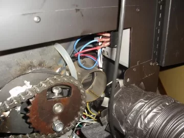

Exactly. Another Harman dealer, and probably Harman as well, will be my next step if he doesn't fix it today. He's supposed to come by.
After he tried to tell me it was supposed to be that way, and I told him that didn't add up, he came over and hooked it up.
I think the install is finally set. At least I hope so - I'm tired of listening to myself give this guy grief of the job he did :)
