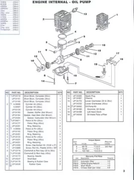

Well I tore it apart and the spring is not broke. I did notice the bearing that was mentioned. That was dry I'm going to try lubing that and that doesn't fix it.
Looks like you need some ne clutch parts.

I lubed the bearing it seamed to help a little. Now when I lock the bar the saw doesn't stall like it did before.
Maybe if I keep messing with that bearing I can get it loosened up more, If that doesn't ork I'm going to look ing replacing it or that cover
not sure if just the bearing can be replaceed.

The parts list and #'s are listed looks like you can just repalce the bearings.
