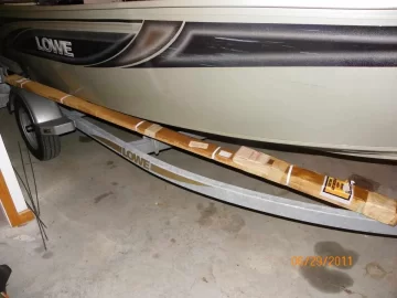

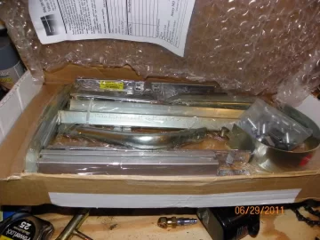

Smokin, looks like everything came in from what I can see, I might start putting it together tonight.
The ez rails (wet) are in the first picture (they had put them outside because I was coming and it started pouring just before I got there) then the second picture is the mill.
zap
Yep yep...Grap a 1/2 wrench and lap-top set at kitchen table about 30 min's your done...Pretty cool video....

Smokin the white plastic piece is not in the package, how important is it.

LOL Funny stuff there!!!!!!!!!!!! I went through the same thing even called them out on it......Turns out its just comes on the SMALL MILL ONLY!!!!! I email back and fourth as well, but it is not a part of your mill. Glad you caught that to! :lol: You are very educated on the mills for sure!

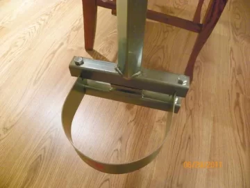

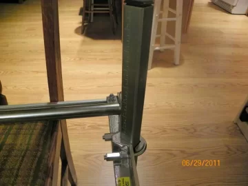

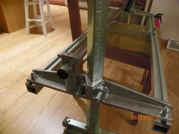

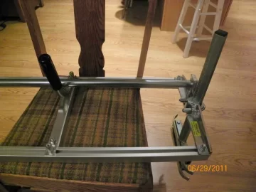

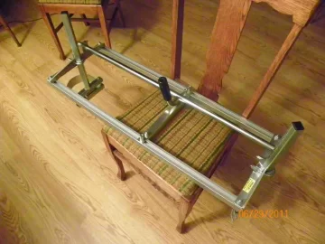

Smokin, how far down did you tighten down the handle from the guide end?
zap
zapny said:
smokinjay said:
Yes :cheese:
zap
Just snug it up until you know what works for you....Mine is about a foot to the left. Could be different once you get going but always keep a 1/2 inch with you for adjustments. :cheese:
Smokin, if you notice something wrong just post it. Looking at the rails tomorrow night.
zap
  • [Hearth.com] Chainsaw Lumbermaking by Will Malloff
