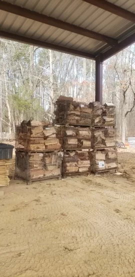

usually try to keep about 20 of these loaded up and ready to go. I can stick 4 in my kiln and in 2 weeks the Mc is right on the money.
