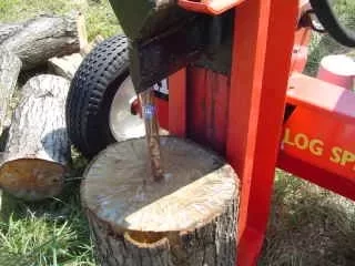

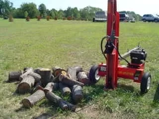

Catskill- I got the same splittah. I had a piece of very dry 3 year old red oak that I just beat myself to death trying to split by hand when it was fresh (crotch of a big tree with extra knots)- I threw it on there Saturday and it bogged the splitter down... then groaned... then it split it. It cut through thr grain sideways and really mashed it up well. When your red oak looks like elm afterwards- you know it was a tough log.
Huskee 22 Ton from Tractor Supply..

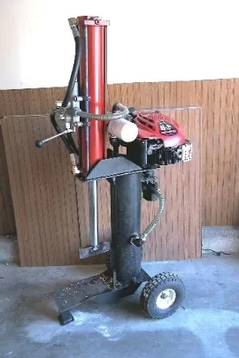

where's the wedge? whats the motor ?
The wedge is extended about 3/4 stroke in the photo - it's welded directly to the hydraulic cylinder rod to save space. I can dis-assemble the cylinder from the other end if I need to, so it's not too bad if I ever have to rebuild. The engine is a briggs 6.5hp turning a haldex 11 gpm two stage pump. Basically, think of it as a giant "C" clamp. The "backbone" is 6" schedule 40 pipe - which also serves as the hydraulic oil tank. It works fine, square pipe would have been better - both structurally and for slightly more oil capacity, but all I had laying in the shop was the round, so I went with it. It looks kind of top heavy and I was worried about it at first, but using it over the years, it's never really been an issue.

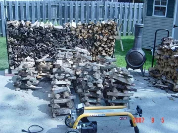

@120 hours and still going strong, last years pic

Wow cozyheat, that is an awesome splitter ya built. Nice and compact for such a high tonnage. with such a narrow wedge do you have any trouble with the splits not wanting to come apart or keeping those small strings connecting between the two splits? I would love to be able to build something like that but alas, I don't have a welder and wouldn't know where to start even if I did.

How long & wide are your rounds??
John
12 inch and under this year, but last year split a few 20 inch round seasoned red oak 14 inch long. This year had a good scrounge of cherry. Split in Aug after 2 weeks in the hot summer sun. Fresh cherry would not budge. If you are interested in one of these, search it out on the forum. Lots of pleased people.Try youtube too.

Not really - I sharpened the wedge to help slice through any knots or twisted grain. It has just enough stroke to have the wedge touch the bottom plate. I'll occasionally hit a piece that is really stringy (mostly free elm that I keep getting) but in that case, I doubt having a couple extra inches of wedge width would make any difference anyway.
