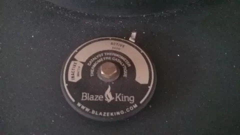

I don't know if this helps,my BK parlor is running at BK's minimum chimney height which says 14 feet,this includes two 45 degree turns ,55 inches from where stovepipe enters stove,and then the two 45's which are combined 18 inches,and a horizontal run of 18 inches then straight up.Now i've never had a problem,yet my thermometer for the cat pegs into the black often,the drier the wood,the higher.Mine settles in at about here after 12 hours,this is this morning elm dry as can be. I wouldn't worry.Mine will bottom itself out if I give it air,watched a fire show last night about two hours on about 5 setting cat probe was in the black.

With the BK's loose the idea that the cat probe can tell a story about temps, the cat probe is only good for when to shut the by-pass (active zone) because of the t-stat the bk will not over fire, unless the t-stat is opened all the way (btw, you should burn it that way for at least 30min once a week)
Remember: these stove are not flame show stoves, if you have flames in the box your burning it for high heat and using it like a regular stove, the stove makes its $$ by providing a clean smoldering burn (yes black glass burn) and extracting the most heat due to cat position inside the stove.
As far as the un-insulated liner, you should have an insulated on with at least 15ft minimum height, just keep an eye on it, check for creosote build up near the cap, when the stove is cruising on low burn, your flue temps with be about 200-250deg range.

At some point the stat will cut itself back to prevent overfire so that huge flameshow can't go on for the whole full load.
So I are you saying the cat is safe from overheat or damage when this t-stat decides to go into fail safe mode?

BK tells us that 95% figure and it's not from overfire due to a leaky door gasket but "thermal shock" from the non-preheated air hitting the hot cat. Ceramic cats are more sensitive to this of course but apparently the steels don't like it either. What happens the other 5% of the time? Well that could be anything from burning trash, defective catalysts, to just plain old wear since the 10 year warranty could include 5 times the rated hours of catalyst life that the manufacturer rates them for.
I don't have an insert. The fans are not optional but since they can be turned off I would expect that the insert is also designed to be run at high stat setting without the fans and not overtemp the stove or catalyst.
It's not a "fail safe" mode, it's normal operation that the thermostat limits the high temperature of the stove. When someone, like @Poindexter runs his stove at the top setting for full loads the stove stat doesn't allow overfire. I don't plan to try it myself though.
I would guess that a brand new cat could be overheated in the same stove that would not overheat a cat with a year or two on it. My first year with the princess insert, I wrapped the needle around the cat probe pretty good once. Same thermostat settings, but with a super-active cat, the thermostat cranks down the air, the wood smokes more, the cat gets even hotter...

You are again making the mistake that a cat probe meter reading above the active line is a problem. There is no "pin" on the meter. Do you have any idea what you are talking about. The cat can run up to 1800 and that is way high on the cat meter.
