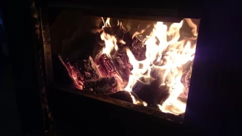

What is the cat doing, glowing nicely for a longer time into the burn? Did you replace the cat flame shield yet? If not, I wouldn't ram big flames up there once you close the bypass. But with a steel cat you shouldn't have to worry about it quite as much...
