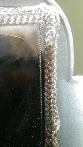

[Hearth.com] Blaze King Ashford Door Gasket/Glass Does anyone feel that my gasket has an issue here? It doesn't look like this anywhere else around the door. You can see here it seals nicely on the top and bottom of the picture but along the center in this picture it seals along the far right of the gasket. On slow burns, I suspect that this is where the cooler gases and smoke are escaping. The gasket doesn't look this way anywhere else nor does it have the odor anywhere else. Coincidence?

View attachment 146484 Does anyone feel that my gasket has an issue here? It doesn't look like this anywhere else around the door. You can see here it seals nicely on the top and bottom of the picture but along the center in this picture it seals along the far right of the gasket. On slow burns, I suspect that this is where the cooler gases and smoke are escaping. The gasket doesn't look this way anywhere else nor does it have the odor anywhere else. Coincidence?
I see the glass is dirty in the same place other BKs are. The gasket is also dirty in the same place the glass is, makes sense to me.
Webby, I tend to agree with you. If the "leak" or smell of smoke were coming from the gasket, wouldn't it be discolored to the right of the seal? Further, I swiped my finger down the right hand side of the frame of the gasket and no soot.
New theory: when I bolted the cast iron front of the stove on, maybe I didn't get it tight enough? This would mean the door isn't coming in tight enough in that area? I didn't really want to come down hard on them because I thought heat would only cause expansion further tightening them...
My handle does only very light latch when I close the door. I just thought man, it's kind nice cause it's so easy to latch and unlatch but seems to be sealing nicely on the gasket.

Can't find where anything is loose with my door or glass. Everything seems solid and I don't see any soot or anything around any of the gaskets indicating a leak. I did a candle test but couldn't really tell anything definitively..

I also don't feel that this has to do with the gasket or the door glass. It does not move. Solid. Gasket seems to pass dollar bill test everywhere as it is new. I don't smell anything coming up from the door when the stove is lit and I can smell it in the room. I have sniffed all around the top of the door. Nothing. It's coming from the left, at the top, in the front, from underneath the top. Somewhere in that corner is leaking smoke/fumes yet I see no holes inside or out in the welding.
