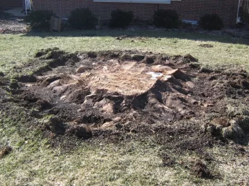

To this day my wife believes this tree didn't need to come down. And it took the stump grinder three passes to get a passing grade. I quit counting how many wheelbarrows (after 20) of noodles I moved to keep exposing more stump. Then I had to find dirt to fill in the crater.

Thats what I was planning on doing, I can drop the other 4 trunk sections no problem. Looks like your stump was pushed way up out of the ground also, thats where all the work is going to be. Just waiting on the ground to dry up now to try to keep the ruts and craters to a minimum. Found a 150 ft 3/8 cable I can borrow.
