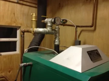

I have baseboard heaters and I have a small house. So how do I fix my problem? More circ pumps? Bigger lines?I was thinking about a modine from home depot to heat the room I just created.
Im going to go take some pictures.

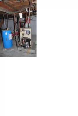

[Hearth.com] Attack 45 profi chimney problems This is what I am tying into with my wood furnace. The water circulates in a 1 1/4 inch copper line around my basement ceiling that has baseboard heat runs off the 1 1/4 inch line. How do I get more water to circulate?

I also think you can't move enough water to get rid of the heat and that boiler seems awful big for that size of house. I have 1 1/2 copper out of my boiler transistioning to 1 1/4 thermopex which runs to 500 gallons of storage. This is my first year heating with wood and its imparitive the wood is dry and split small.
  • [Hearth.com] Attack 45 profi chimney problems
If your house is getting as hot as it sounds - I think your heat is moving but the boiler is oversized for your house. 45kw is a lot for 1500 sq.ft.. You should really have some storage - but if that is an impossibility right now, at least try smaller fires. Like 1/4 of a firebox full. But adequate storage would turn your situation around like night & day - you could likely get by with burning only once every couple of days and still be toasty warm.
