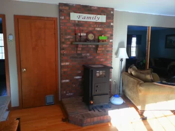

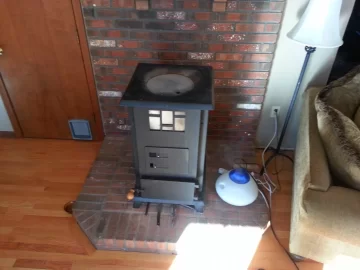

One thing that may not have been mentioned . . . the hearth . . . what is the hearth you have currently and will it meet the R-value requirements for both stoves or will it need to be beefed up?
