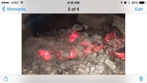

I made some changes Im finding it burns slower and it is better for the combuster if you close primary air to desired place wait for fire to slow down then close bypass. Last night filled at 11pm 9 hours later.
This is what the coals are like.

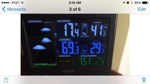

Outside temp and temp in kitchen 25 feet from stove with cathedral ceiling in kitchen with hallway and stairway that leads upstairs next to the thermometer. Upstairs temp is 68.

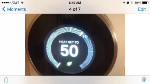

Temp in living room is 75 not the 50 that's where the thermostat is set. Also cathedral ceiling in living room.
