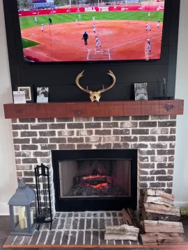

Hello everyone, I hope all is having a good day. I am very new to wood stoves as they are not to big in my area, northeast, Alabama, that I know of. Anyway I just built a house recently and the contractor installed a Heatilator E36 ZC fire place. We are happy with it for what it is, but during the past couple cold snaps lo and behold our heat has not been the greatest. This brought me to looking for a supplemental, secondary heat source. The wife and I both like the wood stove not only for looks but the efficiency we are reading they have.
We also really like the alcove look. This thread caught my attention and I wanted to ask a few questions if I may. Please let me know if I should start a new thread .
Attached photo is current set up, my idea is total the zc fire place out and frame the alcove to meet specs for the stove ,Jotul F55 and keeping the mantel and TV where it is pretty much. I have the room to move the mantel up to meet specs. I plan to brick the inside of the chase and the floor which protrudes in the garage. but the confusion is how high do I need to make the top ? What do I need to install for the top ? The house is on a slab . Is this idea even possible (web picture )? I apologize in advance but I am very new to this.

Start with the stove manual. Alcove requirement for stoves are more restrictive than for a stove out in the open. There are extra details to make it safe and legal, plan carefully. Consider getting a non-combustible mantel. There are some good looking options available that will eliminate this as a clearance issue.

Thank you for the quick reply, looking at the above specs for the Jotul F55. Looks like I can meet all the specs, trying to find something to protect the ceiling for minimum clearance might tough, any suggestions ? Specs attached I appreciate it, I know I got a lot more research to do, wish I would found this place before I got the house built.

If this is being built from scratch, then using metal studs and cement board will make it non-combustible. Search on Alcove in titles only in this forum to see some examples. Here is one to get you started.
