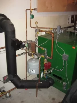

  • [Hearth.com] About to install a Greenwood 100

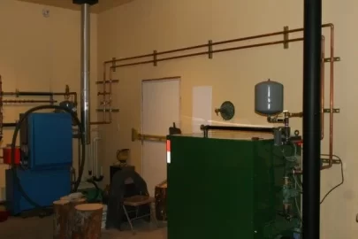

Here is a picture of my install. It is a GW200 in an attached garage. Don't forget to have a way of umping the heat if the power goes out. I open my garage door when loading the boiler to let the smoke out.
Your greenwood will do great but there are concerns. If you are using a knowledgeable plumber he will be able to handle the install. The dump zone in a rarely used slab will absorb all the heat you can put to it. I installed a attic fan and some duct work over the door tied to a timer to pull the smoke outside when I fill the stove. When filling with birch you can't help some smoke pouring out. Been burning with mine for 3 winters in Wasilla and have gotten my natural gas bill down to under 25.00 per month. That includes cooking and haot water for 3 girls and a wife. I have added 800 gallons of storage and am still tinkering but it is paying for itself now...

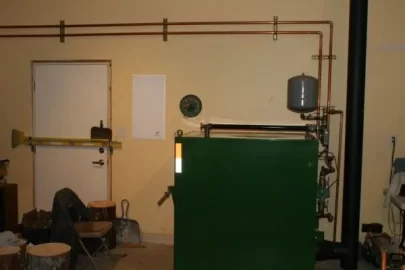

Brought the GW 100 on line yesterday. Went pretty well. 7 am to 2:30 pm to get it plumbed in and filled. Will post a photo as I think the install is sexy as can be. I did my four fire warm up process and began to put real heat to it last night.
I need to get an aquastat installed to dump heat as I saw 230f on the gauge when no zones called for heat. I'm running a closed pressurized system with two 30lb expansion tanks (one on the GW, one on my fuel oil fired boiler) and two pop offs (one on each unit) and did not have a pop off issue even with the temp spike.

Attempting to attach my this weekend install photo. Not sure if you have to open it or if it will display. hmmmm.....
