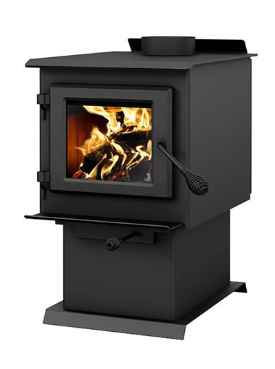

Looking to replace a very inefficient older wood insert that eats the wood at our hunting camp. Realistically the camp gets used weekends and maybe 3 weeks straight in November for hunting season. Its hard to justify a brand new Jotul but I just can't seem to find the middle ground between a used stove or new one. I want something efficient that doesn't use a lot of wood but don't want to break the bank for limited use. My parents have an Jotul F3 that I'm in love with but can't seem to find a used one, yet. Are there excellent comparables. I found a VC Aspen but I'm not sold on the whole auto dampening deal. Any advice or recommendations would be appreciated.
The camp is an older brick building with a stone chimney with a clay flue. Its has a loft for sleeping but I just reinsulated the ceiling so I'd say the insulation situation is "adequate".
