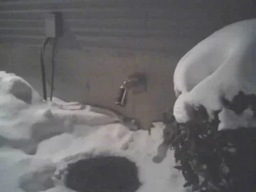

Here is a pic of mine from my cell as my regular camera is dead.
Hopefully you can see it. The 3' foot section does not stick out as
much as you think it does. Got to account for the size of the wall it is in.

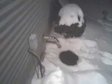

Here is one more....

macman said:
Smokey, from what they describe, it sound like they presently have an EVL of around 14-15....I don't think another foot of horiz. will hurt.
I count 12 to get to the horizontal point, depending upon the altitude at his location and what his manual says I suspect he will be right at the boundary. I say give it a try.
SmokeyTheBear said:
Yep Smokey, that sounds right, but you still have to add the 2-3' horiz. to go through the wall.
Total of about 14-15 at the cap.
He's in Missouri..... don't think there's too many places with high elevation there......another foot won't hurt, IMO.
