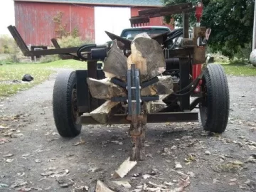

4-way splitting wedge.

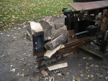

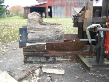

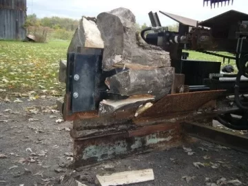

I think I got it so I'll add that it was a three year old piece of maple, 13" at the small end.
  • [Hearth.com] 4-way splitting wedge.
I am interested in building a wedge myself. It seems easy, but the impression I am getting is the are some 'gotchas' I am not seeing. Any idea what the main design concerns are?
Was the gentleman that built your wedge able to take the details of your design over the phone? Or can I throw something together with Google Sketchup or something?
He asked what he needed to know and I gave it to him.
Real easy.

You can see the hydraulic lines and the mount for my frugal attempt at the saw.
I'm using a chain saw now until the money opens up for the proper set-up
lest I come up with something in the mean time.
Gotcha. Splitting has always been where my process gets stuck. I always seem to have 4 or 5 cord of rounds waiting to be split. Hoping the 6 way will fix that.
Don't say you weren't warned about the power needed for a 6-way in hardwoods.
Let me know how things work out or if you want to stop by, pm me.
No guts, no glory:) Thanks for sharing your experience, you probably saved me at least one round of failure.
