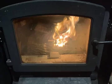

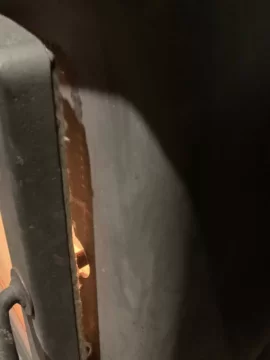

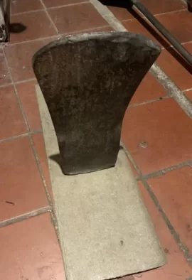

I did with a chimney cap. No cap and not much smoke. But it’s been tougher to get a good draft and big fire without the cap.I have the Nova 2. I have to leave door open forever to get good fire going before shutting door. Fire can be ripping, I’ll shut the door and it will die right out.
Are you getting lots of smoke roll out when reloading wood with fire going?

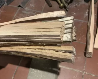

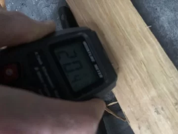

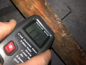

This morning I put a big bundle of split 2x4, 2x6, and slab wood and 4 sawdust bricks. Went to bed with it packed as full of 20” splits as I could. And had a good coal bed to start that.
Excellent draft once they lit. Wind does seem to be from the north more than NW.

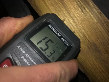

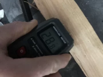

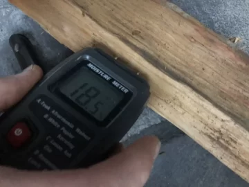

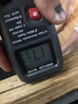

My firewood must not be dry enough.
