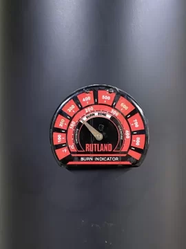

Do I need one of these? Bk king burning almost all midwestern hardwood. Right now I have magnetic. Can a bk be over fired?

Do I need one of these? Bk king burning almost all midwestern hardwood. Right now I have magnetic. Can a bk be over fired?View attachment 253717
Probe for double wall and magnetic for single wall. You want to monitor flue temps because they can fall very low and gunk up your flue even with an active cat.
Using normal fuel, operating per the manual, with functional gaskets and an otherwise healthy stove you can’t overfire your king.
This is exactly what I have, a probe on the stove with the double-wall, and a surface thermo on the stove with the single wall. But I’m quoting this since it’s so immediately applicable to Diabel’s statement, it’s not uncommon to see accumulation in the stove pipe close to the stove.

Ok so I understand, do I really need one?
It's giving you more immediate feedback on the state of the burn than a stove top meter does. As Ashful said above, he uses the info to assess whether he can close the bypass and get cat light-off. Others have said that if forced to choose, they would sooner have a flue meter than the stove top.
Ok. We are looking for 4 to 500 degrees? To light cat

Ok so I understand, do I really need one? My stove is rarely ran low. Big house and basement install. Do I really need the information?
I asked the same question a few years ago in the BK thread. BKVP himself told me nope, not needed. Go buy a nice bottle of your favourite instead.
( In BK I do trust, but that said, I do have one and I do like seeing the flue temps...!)
I agree that you could survive without a flue meter. You need a cat meter on the stove to fulfill the manual's directions. Don't even bother trying to measure stove top temperature!
Twenny bucks ain't gonna get me a bottle of my favorite. ;)
No such thing as too much info, in my book. ==c

The main two things I do with flue gas temp probe is keep the indicator below 1000dF during regulated cold starts, and know when I am down to just carbon at the back end of a burn.
Just keep in mind if the draft is excessive, then yes you can over fire a BK. You mentioned operating per the manual, which that is in the manual .05 on high .06 MAX., so I guess you covered it, but I just wanted to highlight that.
I don’t think the stove will melt as the thermostat will dampen it down some but the thermostat is designed to operate within a certain draft specs. Maybe cook the cat would be the worst of it. Other stoves, could be really bad.
