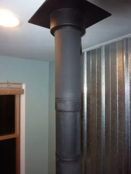

Hello Mr. Vice President. You are not going to like my chimney setup :). Here is the post where I was asking about if my setup would have draft issues. I am open to suggestions on ways to make it work better.
https://www.hearth.com/talk/threads/blaze-king-ashford-30-1-draft-question.156963/#post-2106492
I am pretty sure I can turn up the thermostat to high and the cat comes back as you suggest. I don't know how the CAT works but I don't see it just stopping all of a sudden, it seems to creep down and go into the INACTIVE range over the night even though there appears to be plenty of wood in the stove. I am thinking draft issues because if I leaved it turned up higher this doesn't appear to be an issue. Though I have only been burning 5 days or so, so still learning.
I would often find my Ashford in the inactive range in the morning. I'd simply turn up the stat while I make coffee and it's back to life in no time. I have a minimum height flue and just learned to accept it. It's not a big deal to me at all.

I think I am getting better at burning in this stove. Glass is starting to clean itself off. Trying my best for the 20 minute high burn after reloads. Also I got home from work at 1am this morning and the stove was getting down in the inactive range. I turned it up a bit and it was still in the active range when I came down at 5am to go back to work. Yes the wood I mentioned before is basically giant wood shaped charcoal just really big pieces with a lot of fuel left in them still. I went 14 hours between burns yesterday and I could have gone longer but I didn't want my wife to worry about the stove while I was at work last night. I loaded it completely this morning and will see if it goes until tomorrow when I plan to let it go out for a check up. Thank you all for the quick advice. I wish they made some sort of flexible double wall chimney that was approved to install free standing so I had more options for my stove placement. Oh and Mr. BKVP thank your teams for making such a hassle free stove (compared to others). I haven't had overfire anxiety all week. Just smoke smell anxiety :p.

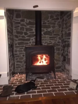

Does anyone have decent pictures of a scirocco with legs and full satin trim?(door and legs) My bk dealer doesn't actually have bk stoves so I want to see one before ordering one :)
Sent from my SGH-I337M using Tapatalk
The picture of the Sirocco 30 on the BK website has the satin accented door and trim with legs.
[Hearth.com] 2016-17 Blaze King Performance Thread (Everything BK)
Ha OK didn't even realize it thought it was reflection of some sort. Thank you.
