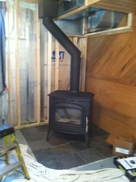

Can you post a picture of your setup? Creosote should go back into the stove unless the pipes were installed wrong.
It does sound like you are burning wet wood, that and coupled with fall temps will not help the draft.

Your photos were posted while I was typing the post above. Can't read the labels. Is that single or double wall?

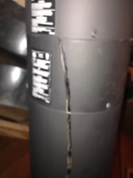

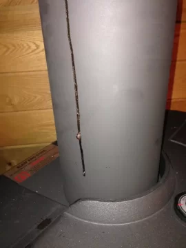

Does the leaking creosote mean I have too much creosote in the chimney? Thank you
Shoo42, creosote should not be able to drip on the outside of the pipe if installed correctly. The crimped (male) end is supposed to be pointed down, toward the stove so that any creosote drips back into the stove.
Is this single or double-wall stove pipe? What is the distance from the the stove pipe to the wood up near where it joins to the support box? How much chimney is there above the chimney support box?
is this single or double-wall stove pipe?
Creosote should not be able to drip on the outside of the pipe if installed correctly. The crimped (male) end is supposed to be pointed down, toward the stove so that any creosote drips back into the stove.
I'm not a 100% sure. I believe the black pipe is double and I know for sure the rest is class A double stainless. There is even a creosote leak coming out of one of the little screws in the black pipe.

I mean it's either upside down or it isn't. If it's not upside down it shouldn't leak outside the pipe. I don't understand their answer, "see it keeps leaking". This also means rain water that gets driven into the pipe will end up on top of the stove too.

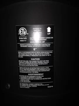

Can you post an in focus image of the label on the stove pipe?
Looks like excel to me. A nice shot of the label would show pipe direction.
