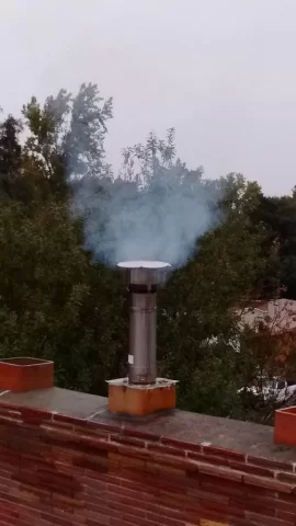

Ok, Started a fire. About 15 to 20 min in on high, I close the bypass as the guage says it's ready. Two min later, this is what's coming out. It's a little blue in color. Still on high.

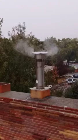

I let it run another 15 min on high, and slowly damped it down over another 10 min. Once I got it back to fully closed, with the exception of the small hole drilled in the piece of metal that blocks the air. I'm now at the lowest setting, and it's just cruising where I want it to being warmer out and raining in the shoulder season. It's 50 out. Here's a pic when the stove is 3/4 to high on the gage, and running on low. Notice the smoke is more white?

It must still be a little wet.
The top picture is mainly steam with some smoke. The bottom picture is just steam. Notice how it magically disappears after a short distance? Steam, normal. Bring 3 days of wood in the house, if possible. Let it dry, using the oldest wood first. Nice looking wood racks are not too costly.
It's been in my basement since last fall. It grew mold. I opened two windows and put a box fan in one to draw dry hot air all summer long to address the mold growing problem. Again, it tests between 15 to 20 percent, with a few in the 30 percent. Maybe there's a few in the 30's lurking in the pile. To compensate, Iv'e started to split them again, so they're basically extra large kindling pieces now. That way I can try and drive most of the moisture out in the initial burn before I close the by pass.

Opening a basement window is counterproductive, as that hot summer air contains more water than the air in your house. Best to keep wood outdoors drying, at least until fall, and keep your basement sealed against that humid summer air!
@Mr. Jones , post 408 above is a lot wetter than 14.x % average MC. I agree with @kf6hap the second pic shows a steam plume, esp give reported outdoor ambient of +50dF.
Have you downloaded the manual from bk website? I havent read them all, but i expect the manual will tell you to get the stove up to temp, close the bypass door, then run the load on the high tstat setting for 30 minutes before turning the tsat down.
Running 30 minutes on high will boil a LOT of water out of your wood, and give you likely a much smaller steam plume.
