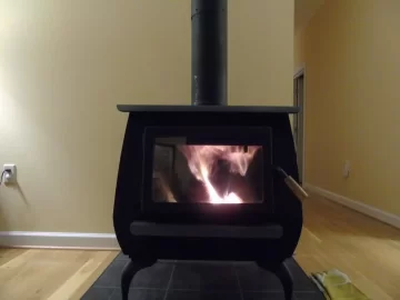

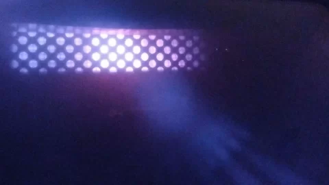

Getting ticked off now. I don't know what the heck to do. I've spent so much money on this set up, and it still continues to smoke worse than my 1984 lopi slammer in my pic. I've done everything I can think of. Replaced everything I know to replace. Either there's a crack in the stove letting smoke bypass the cat, or something is up. My new liner isn't gonna last a year like this. It's sticky wet like crap in my stove building up, yet right now it's very volatile in there. Almost scary since my cat keeps glowing too much for my liking, so I open the bypass, and damp it down more. If I give it a little air, it wants to act like it's got burn tubes. That's not wet, that's lets burn mode. Feels great in here, but I go outside, and white smoke it billowing out.I'm running this stove the way it's supposed to be ran, slow and steady, and smokey, and the cat is supposed to do it's job eating the smoke and making heat. Well, it's getting plenty red hot, so I don't know where all this smoke is coming from. I'll make a vid of it when it's cold enough during the day to try this out. I get to the point I just wanna open the bypass and let er burn HOT and clean. The ONLY other thing I can think of is that I used regular caulk/silicone mix up on the chimney cap, between the top plate and the liner coming through to block any air getting out. Maybe that's getting super hot and smoking, but I doubt it.

White smoke is the moisture being driven out of the wood. This is typical for the first few hours of the burn. Check the stack after a few hours and I bet it will be good to go.
My new liner isn't gonna last a year like this. It's sticky wet like crap in my stove building up, yet right now it's very volatile in there... That's not wet, that's lets burn mode. Feels great in here, but I go outside, and white smoke it billowing out.
Smoke is usually black. Steam is white. Steam comes from wet wood.
Have you tested your wood using a moisture meter? Describe your procedure for an accurate reading.

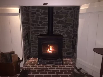

I'm thinking wood stove, a little Jack Daniels and a flannel nightgown. And some mindless t.v. Dog sleeping on his bed. Husband "resting his eyes on the sofa." :) :) <:3~
And a picture. For y'all. :)

One thing I need to do better is damper it down slower. What happens is I have a raging fire going trying to burn out the moisture. Then I close the bypass, and damp it down. The flames go out, and all the sudden the box fills with cat fuel, and the thing glows like crazy, until it starts to smolder less after some time, and finally stops glowing. What I hate about charring the wood first is half the fuel and burn time goes right up the chimney. Not used to having to do that.

My cat lights up the living room floor very often.
