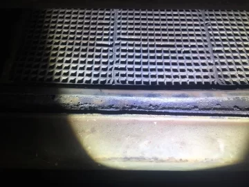

Cat is not visibly plugged, light passes through around that whopper heat sink behind the cat just fine. Fine grey ash accumulation behind the cat in front of the bypass door looks normal.
My flame shield for the cat is warped at least half an inch is the only thing I can find "wrong" with the stove - other than it heats the house like the cat isn't working.

I too think my cat is roasted, unsure of mechanism and should dollar bill test the bypass gasket before i relight it.

Cleaned the princess insert this weekend and found some more missing pieces of the cat. Will it be okay or should I be in the market for a steel cat???

Unless the cat actually falls apart it is fine with chips, cracks, and weird colors. Be sure the meter goes active, and that the holes are not clogged.
