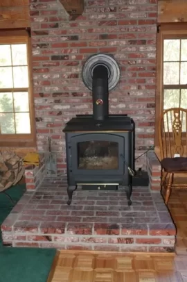

Last year, you all helped me through a purchase and install of an Englander 30. Everything worked out great, and I have attached a photo. Now, I am looking into replacing a fireplace and am looking for ideas.

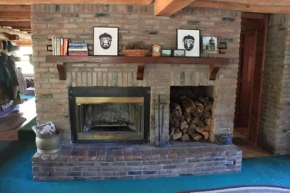

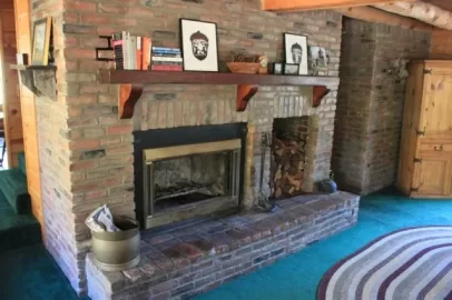

This cabin is a second home, so we are often heating it from dead cold in the winter. We spend the majority of the time on the main floor. The Englander 30 does a fine job of heating the main floor, but it does take quite a while when the cabin is cold to heat all of the logs, contents, etc. The fireplace that is currently in there is a Heatilator Mark 123 (pictured). The hearth around the stove is 2x4 wood construction, with brick veneer. The hearth appears to be full sized bricks mortared onto 2x4 and plywood.
So our thought is to replace the pictured fireplace with a second wood stove (or possibly another pellet stove) and wanted to get some ideas on what would fit and be a reasonable solution. Our goal is to be able to heat the entire cabin quicker from 40 degrees, and also to simply replace the degrading, useless fireplace with something that is useful. I realize that whatever I do, I will need to replace the chimney system as well.

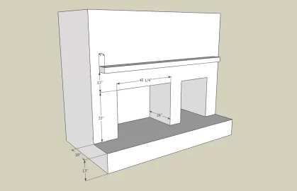

1. Is there a zero clearance insert wood stove that would fit into this spot considering the dimensions I have to work with and the location of the mantle?
2. What would be everyone's recommendation on a ZCI wood stove for this application?
3. Is a wood stove the best option here, or maybe a pellet stove?
