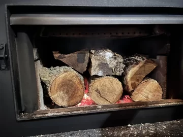

I survived the artic blast with ease! I've been doing night loads like pictured. A couple hours after reload on Saturday I checked the faceplate temp right above the door and it was just over 600F. It had been blasting secondaries for a solid hour at this point. Is there any other place I should check temps instead? I've been mixing Burr Oak, Mullberry and Ash and have plenty of red coals 8+ hours later to get it going in the morning. OAK is taped half off but still just dangling into the basement while I wait for warmer weather to cut a hole in the house. Maybe I'm just not familiar enough with how an EPA stove should run with the secondaries, but it seems like the fire just ROARS.
The load looks good. Turn down the air as soon and far as possible without losing the flame entirely. A flue thermometer helps here, especially if digital, but this would require drilling a hole in the chimney pipe.

Yes I have read that thread. I love that method for cold starts. With burning 24/7 now I'm almost always reloading on coals and rarely open the air up at all.
