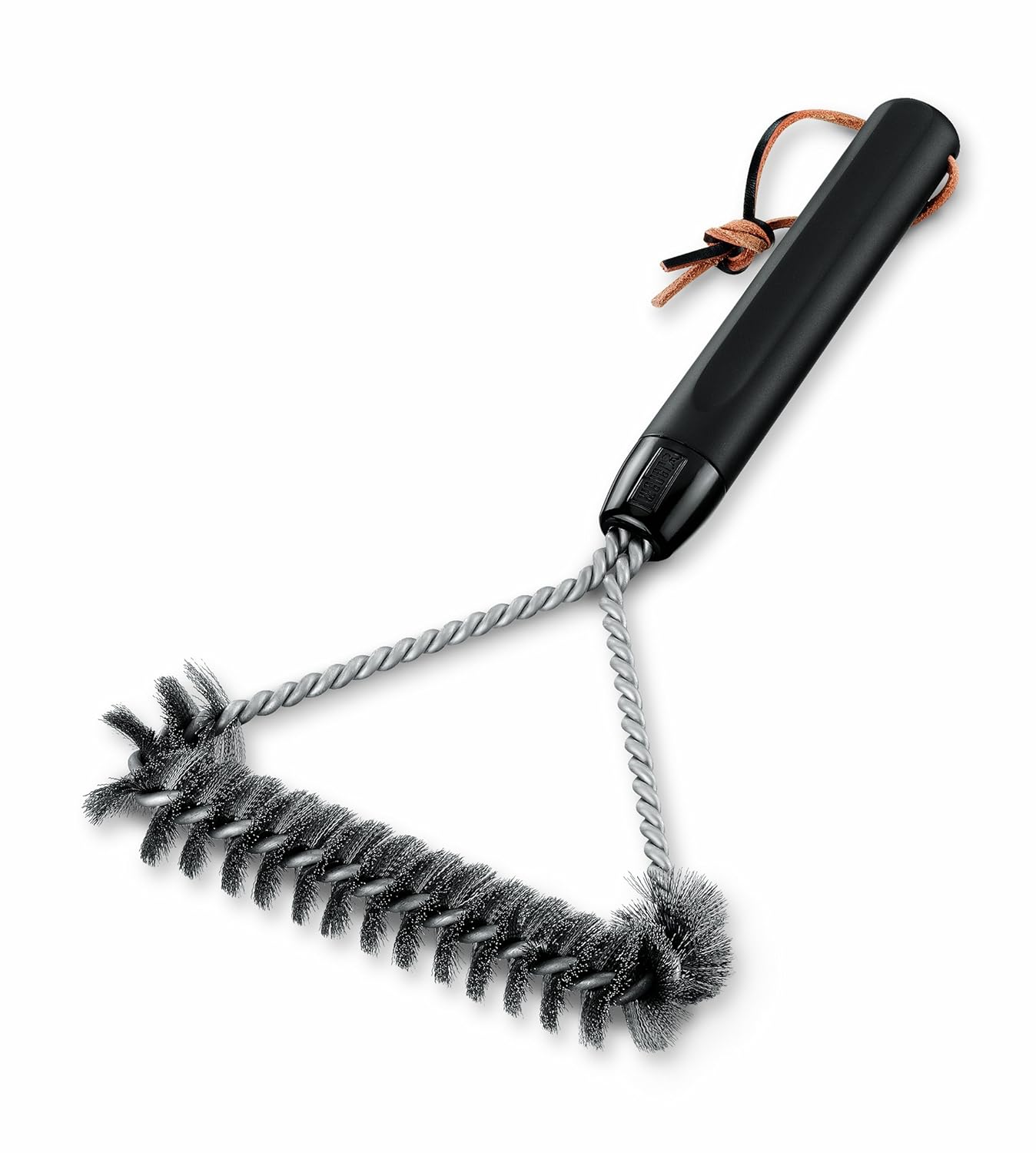

However, I noticed during this recent cold snap (-18°) when I had the settings at 9/9 that each day the stove's body would get less hot.
When I did my weekly cleaning on Saturday I used a brush similar to this one to clean the heat exchanger which gets quite an ash buildup.
The difference was like night and day. The XXV's body actually felt significantly hotter than before and I was running at a lower setting.
Now every time I scrap the burn pot I also use the brush on the heat exchanger directly behind the flames to remove the ash daily.
